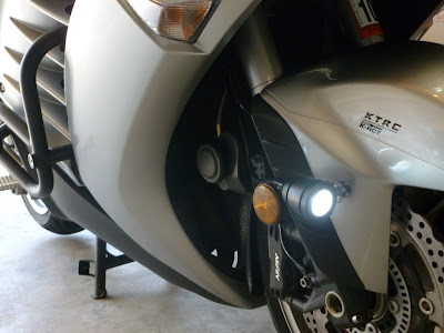

Finishing up the install of these today, once the mail comes and delivers the waterproof connectors I ordered.  I mounted them to the front fender bolts, so we'll see if that works out.  I like the install in the reflector mount also, so I may move it back there at some point.  Here are some pics.
Finishing up this and installing the HID kit and air filter today.   Everything will be white when I'm done.
2012 Black Concours 1400

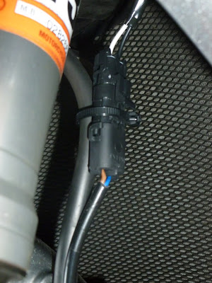

Ok, got everything wrapped up finally.  MM10's installed, 6000k HID's installed, fixed my stripped motor mount on the right side, changed the coolant and air filter.
Waterproof connectors I got off eBay.

Nice install, I thought about placing a switch there but have not decided if I want to put a Powerlet there.  Can you provide a link for those connectors off Ebay?  thanks
Sure, this was the cheapest place (perfplusconnection). The instructions call for a special crimper, but I was able to work it using and insulated and uninsulated crimper.
http://www.ebay.com/itm/370612245715
