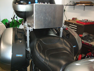

Then last winter I started work on getting a fuel cell mounted above the passenger seat. This took over 2 months of picking away at it to get the mounts and hose routing right:
The fuel cell is a Jaz 5 gal with foam inserts from Jegs. I also got all the fittings from Jegs and it took a couple of routing attempts to get it right. The hole in the bike gas tank was nerve racking but in the end not as big a deal. I followed what Davo Jones had done and put the hole on the bottom of the tank.  The first week I was paranoid that it was leaking but after several inspections, no problems.  I did have issues with the flow, the original route was under the left side of the seat using gravity. I never got good flow, probably from me sitting on the seat squishing the hose along with what others have found with venting.  I then decided to get a small transfer pump to put under the seat. The brand is Facet. I mounted a switch and I just timed how long to let it run. Probably not the best way but it worked all summer.

Here are some pictures that someone requested of my fuel cell mounts under the seat. The smaller alum brackets came from Menards and the larger rear ones came from my grandpa's scraped boat lift.
Here is the pump where the tool box used to be.
I cut lots of plastic from the bike so it might not be the best way for some people that don't want to do that.

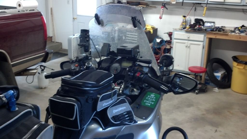

Figure it should be time to update this thread again with some new additions before the big show.
New cockpit view of gps mounts
With the tankbag on it, still need to find a place for my gopro.

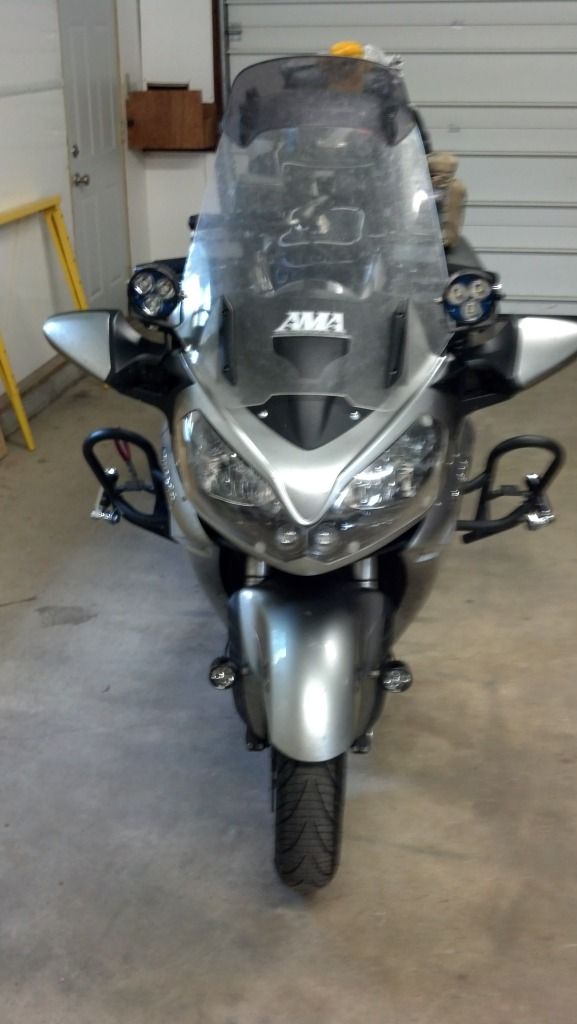

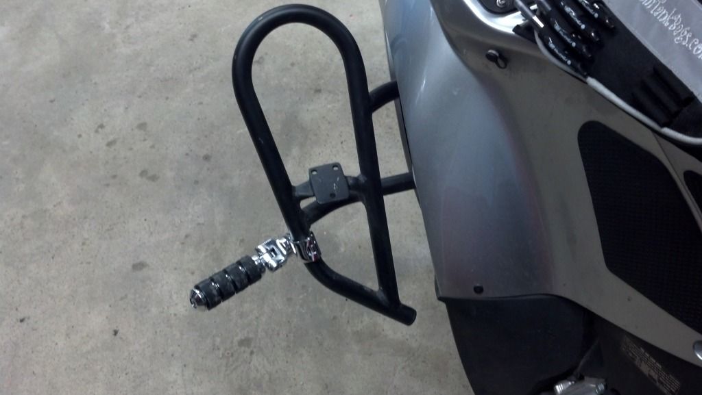

I needed some highway pegs to stretch my knees out since I've been having problems with that this year.
Added lights to the front fender and you can see the pegs too.
