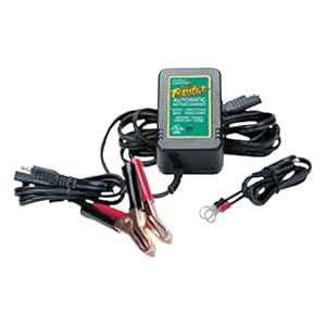

So, is there a preferred brand for battery tenders/float chargers?
I probably should have invested in one years ago, but never have. I have a plug right near the bike and can hang it on the wall or make a shelf for it that would be perfect.
I use this one.
~$25 at Amazon.
http://www.amazon.com/Battery-Tender-021-0123-Junior-Charger/dp/B000CITK8S/ref=sr_1_1?ie=UTF8&qid=1362150857&sr=8-1&keywords=battery+tender

I use this one.
Same here on two bikes. My 2K8Z1K battery will be five years in a few months and still starts the beast when called to duty.  :D That battery is only a fraction in size to the C14 battery.

Ditto on the tender Jr. at Amazon. Ditto on working with the old battery first.
Right now I am doing this on my aunt's car. Rarely used, battery went flat. Thing about a tender is they require at least 3 volts existing in the battery before they will begin working. Connected to aunt's battery, just got flashing red signal. Then I put the old fashioned charger on it for a few hours, built up the volts, re-connected the tender Jr., and it worked. After a few days went over and it was still charging, ie, red signal still on constantly. Disconnected and the battery had enough volts to start the car. Rode around about an hour, came back, parked the car, re-connected tender Jr. and it continued charging. So now if tender Jr. never changes to constant green signal, most likely the battery will never fully charge and something has gone bad in it and needs to be replaced.
So if after connecting tender Jr. and your battery never reaches constant green signal, your c14 battery needs to be replaced.

So, maybe I should get one of these instead:
http://www.amazon.com/Battery-Tender-021-0128-Plus-Charger/dp/B00068XCQU/ref=sr_1_6?s=automotive&ie=UTF8&qid=1362156147&sr=1-6&keywords=battery+charger
Double the price, but I may be able to save the current battery with it if it doesn't have 3v in it.
