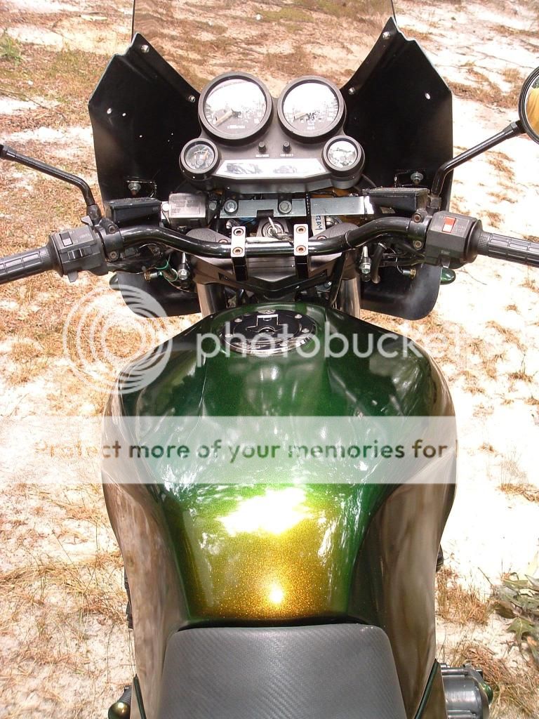

Instrument panel from any 900/1000 Ninja from 85-93 is a plug and play self contained and sealed swap. You will need to temporarily snip the white wire on the large harness on the Conni side, or disconnect it from the plug, as it is the clock circuit, on the ninja side of the harness that wire is the kickstand down light.
fabricate brackets that tie to the top tripple tree clamp bolts, they are pretty close and offer the best support option there.
here's what it looks like.... ;)

another nice benefit of that cluster is it has a voltmeter function built in...very convenient. ;)
