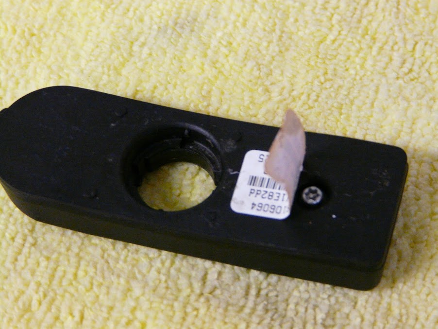

You only need a small torx bit and a soldering iron once you have the unit unscrewed from the wheel.
Peel back the FCC label and unscrew the torx screw.
Pull off the back by releasing three plastic tabs. (one on the round end and two in the hole.
The board just sits in there. Pull it out.
Fold the tabs of the new battery over to the board contacts and solder them on.  (Note polarity)
Profit

« Reply #11 on: May 02, 2013, 12:35:10 PM »
- Peel back the FCC label and unscrew the torx screw.
- Pull off the back by releasing three plastic tabs. (one on the round end and two in the hole.
- The board just sits in there. Pull it out.
- Fold the tabs of the new battery over to the board contacts and solder them on.  (Note polarity)
- Profit
Touché!  ;)
That gives you one minute per step after the TPMS is removed.
I agree with maxtog: Seems doable if you've done it before and have all the tools and supplies ready.
