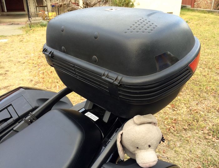

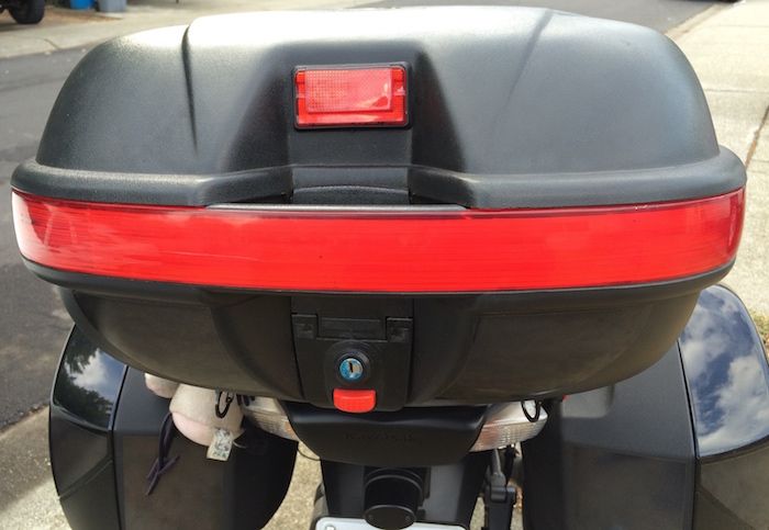

I installed a JC Whitney trunk on a Givi rack. I recommend using a Givi rack or making a custom rack yourself. The provided mounting hardware is the weakest component of this trunk. It is possible to mount the provided trunk plate on the OEM rack but I highly discourage that approach. It fits just fine on the Givi. The trunk functions the same as a Givi and is quite a bit less expensive.

Did the trunk fit exactly on the Givi mounting points & latch?? Or did you have to do some modification to get it to fit?  It seems the fit depends on who makes the trunks for JCW & Sometimes they fit and other times not.

My trunk was @ $70.00 from JC Whitney. The trunk fits fine and latches to the Givi rack no problem. The only issue that you may have is a bit of play vertically at the back while latched. The remedy is to build up the rubber bumpers or spacers under the backside of the trunk. There is a bit more play at the rear of the top box than that of a stock Givi top box on a Givi mount. I first mounted it with a rack I made with Givi mounting hardware and an aluminum plate. It had the same spacer issue. I saw a Givi rack at a great price so I purchased it and replaced my “custom” job. I have had no issue with the trunk or stability at speed. It has been up to 125mph with no problems.
my experience exactly.

Does it come with the stuffed <whatever that is>? ;D

I recommend putting a gasket in the lid.  It will make it waterproof when closed.
Personally, I don't think the JCWhitney trunk goes with the look of the Concours.  I think it was fine for the KLR, but think it cheapens the look of the Concours.

Lol that is my pig. He rides with me. One day I fear he will decide to bail and I will be left alone.
