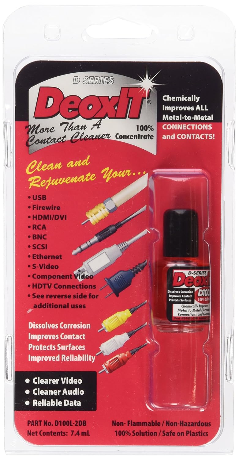

The bill will arrive shortly, please be prompt with the payments.    ;)
I would suggest using a good quality, plastic safe, contact cleaner to coat the contact points that you just cleaned up.
This contact cleaner is the best available, IMO.
https://smile.amazon.com/Booster-Electric-Connection-Enhancer-Lubricant/dp/B0002BBVN2/ref=sr_1_2?ie=UTF8&qid=1472665579&sr=8-2&keywords=cramolin
