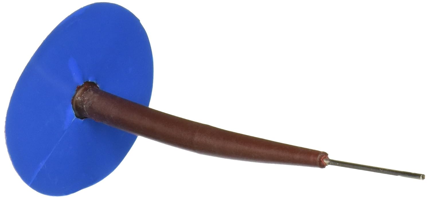

If I were going to try to repair it, I would go with something like this.  Best of both worlds. YMMV
https://www.amazon.com/Tru-Flate-15-296-Plug-N-Patch-Rubber-Integral/dp/B000CIUOVA
  • Posts: 11336
Re: Screw near the side of my 3 week old tire... possible to plug?
« Reply #9 on: February 06, 2019, 07:51:43 AM »
That's what I used in the good ole days in the 70's on car tires.  Never had a call back.

I think I will get some to carry with me. Sounds like they may come in handy if a plug wont work and a tire cant be had.
