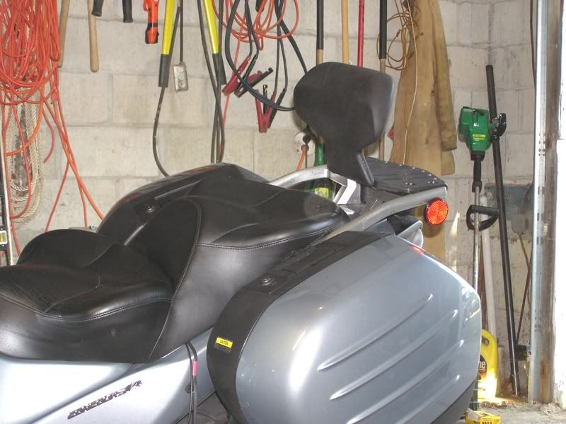

A lot of us have been using the inexpensive Givi series of backrests for years. They are something like $80 and adapt easily to a C-14. The bike has to be modified slightly though to mount the backrest unless you are using a Phil's rack that is meant to hold this backrest.
http://www.twistedthrottle.com/imagecatalogue/imageview/4165/?RefererURL=/search/?SearchText=tb19
Once the rack is off, two holes have to be drilled through the ears of the lifting rails. This photo shows the backrest mounted to those two new holes in the rail system:
The holes are 9/32 and go right through the entire rail. The hardware that comes with the backrest can be used to fasten it to the bike. Do not overtighten the nuts on the bolts as the rails themselves are plastic. The backrest also has to have the ears bent or it will sit at a very forward angle. A vise is best to bend the ears although a large adjustable wrench can be used if you are careful. This is what it looks like mounted on the bike:

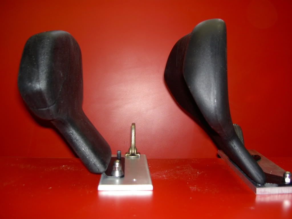

Good post, another option is the Givi TB531 scooter backrest. Here's a comparison of the two back-rests from the side (TB531 Left, TB-19 Right):

I don't recall which one I used, but here's my version.
Sad that thread is lost.
What I can say is this mount is not strong enough by itself. I use a stock rack cut down that puts quite a bit of forward pressure on the backrest to keep it from bending back, or breaking the lower rack it is bolted to.

Nice job on the backrest Brett, and great photos of the install.
I had to bend the backrest on my bike way back from the original angle or it drove my wife forward far too much. In the end, I think everyone is going to have to 'adjust' the position of the rest for his / her own personal needs.
I just got done mounting a Givi 55 in place of a smaller top box and my wife could not sit properly in front of the new top box. I ended up making a custom mounting plate to drive the Givi 2" further back than any stock mounting solution that I found. Motorcycles are kind of finicky as they fit us, cars are much more forgiving.
