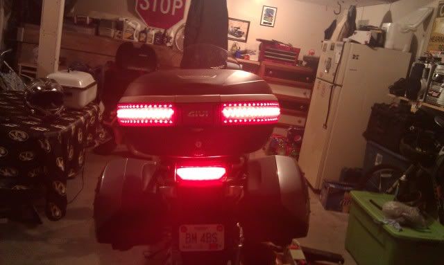

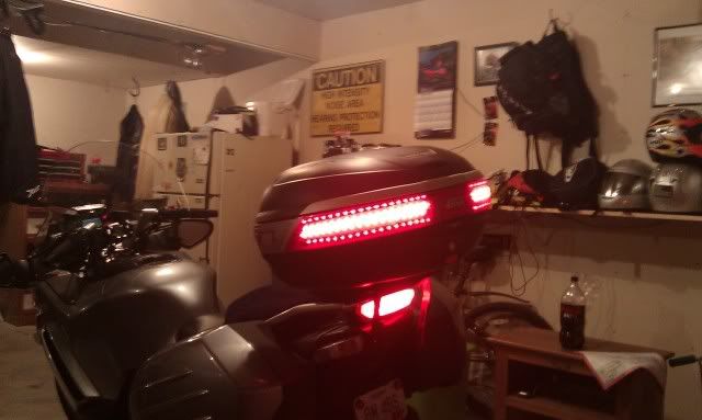

I wired my own lights (tail, brake, turn) into my Givi.  All it took was some LED strips, four pin trailer harness (male and female side to make everything quick connect), and two hours of time.  I am pretty happy with how it turned out, I just need to figure out how to get the LEDs to cycle all the way off during the turn signal flash.
The brighter middle row is the brake light.
