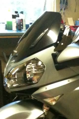

I did mine with a rattle can of satin black.  I've done 2, both turned out fine.  I paint the "back" side, or rider side, of the shield.
Top pic is of a OEM shield cut down 4", the others are the OEM shield just painted.  I needed a cut down shield for summer.
*EDIT*
I'm 5'9" ish and the OEM height painted shield is not a problem to see over.  FYI>

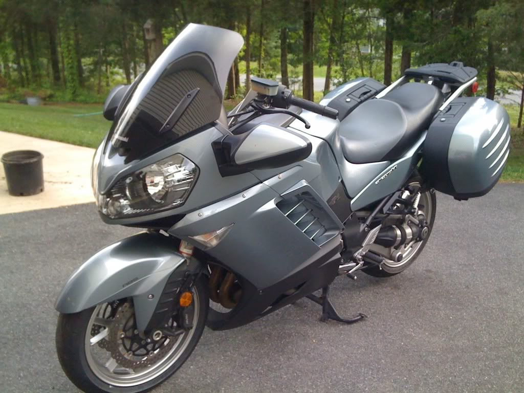

calsci tinted shorty.
Might be for sale if my tint job goes well on the stock shield.
Re: I want to tint my windscreen. What are the options?
« Reply #14 on: September 27, 2011, 11:01:34 AM »
The blacked out screen looks awesome compared to the clear. Does anyone have a pic of the cal sci tinted shorty for comparison to the full blacked out?
Here's more pics of the shorty on a more beautiful and faster '08.
