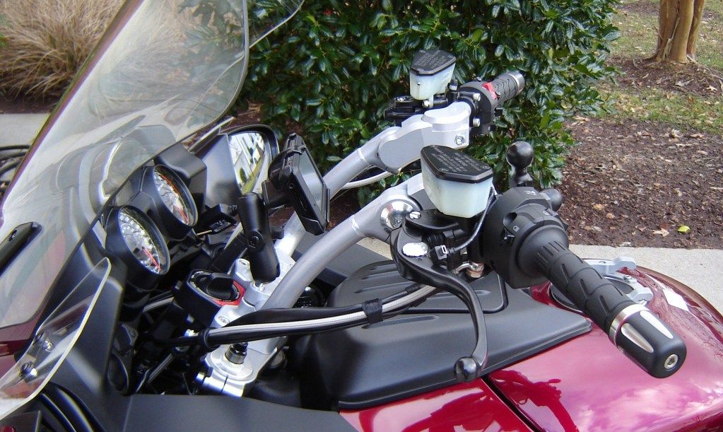

I've had quite a few long rides on mine since the install.
I took mine to the dealer for the install.
Pros are almost everything.  Adjustability is phenomenal...I thought I'd be able to rotate the grip angle to some degree (like between 3 and 4 o'clock), but that's the one adjustment you can't quite get.  But I'm comfortable, so I'm pretty happy.
Only real downsides to me are in inability to reduce the length back to the rider.  I wish they offered a version that was maybe 1-1/2 or 2 inches shorter.  They come a bit closer to me than I think is ideal.  I feel like I need to move a bit farther back on my seat, but I can't.  I'll address that with my new seat.  Other than that, I think the looks still aren't great.  But I bought the bike to ride, not to be looked at.  ANd I can ride much farther, much more comfortably.
Handling feels even better to me now, as the grips and reach are better than stock.  I took it up to the mountains last weekend for the first time and I was very, very happy.
If you can afford it, do it.  And I definitely agree on the longer lines.  That's what I did, and they look great and feel great.

I installed mine...real easy to do. I have just the line extenders, which don't look great, but the install is a lot easier than doing the longer lines since a full bleed is not necessary.
As far as comfort, it is 1000% better than when I had murphs risers, just wedges, wedges and risers. Nothing worked until the Horizons. Now I can ride for as long as my butt will allow (seat to come next) without any problems in my wrist/arm/shoulders. Nice comfortable neutral sitting position now.
My only negative is the same as Billyzoom's. I would like them to be adjustable to shorten the extender bars. I am 6'2", with long arms and an inch or two shorter would be great when hitting the twisties.  Now, on  WVA ride last year, I had no problem leaning into the bars, but I felt my arms where just a bit too bent when really leaning in.
There is another option out there that may work. http://www.zggtr.org/index.php?topic=12644.0
Wish I had the $ to get a set and test out. I'll just stick with my Horizons, and work on getting a new seat done.

I have a set that I installed.  I replaced both full lines and the clutch was a PITA to bleed, otherwise it is pretty simple.   As stated the adjustment is great.  I can understand how some feel they could be a little close but that just allowed me the ability to get into the comfortable portion of my Laam seat.  I spent a lot of time and money on other options and in the end I should have just bought the Horizons first.  I cannot think of any reason not to purchase them.
Also take a look at ZG's option.  They may work better if you have long arms.
